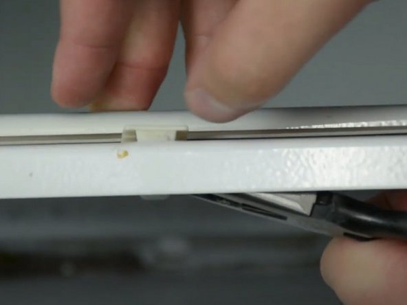

  2. Fast Fix Whirlpool Cabrio WGD5500XW1 Door Latch Replacement: 手順 2、 2の画像 1 Fast Fix Whirlpool Cabrio WGD5500XW1 Door Latch Replacement: 手順 2、 2の画像 2
    • Take the pliers and clamp onto the strike.
    • Push it from one side and then lift it out on the other side.

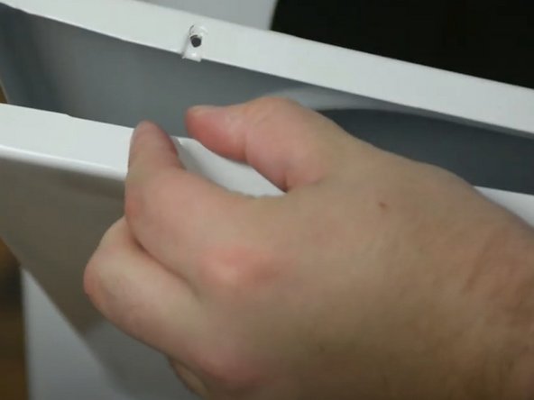

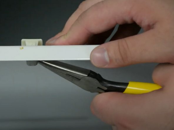

  4. Fast Fix Whirlpool Cabrio WGD5500XW1 Door Latch Replacement: 手順 4、 3の画像 1 Fast Fix Whirlpool Cabrio WGD5500XW1 Door Latch Replacement: 手順 4、 3の画像 2 Fast Fix Whirlpool Cabrio WGD5500XW1 Door Latch Replacement: 手順 4、 3の画像 3
    • Take the new strike and set it into position.
    • Using a bottle nose pliers, push on one side of the strike until it's in place.
    • Using your hand, push the strike into place.

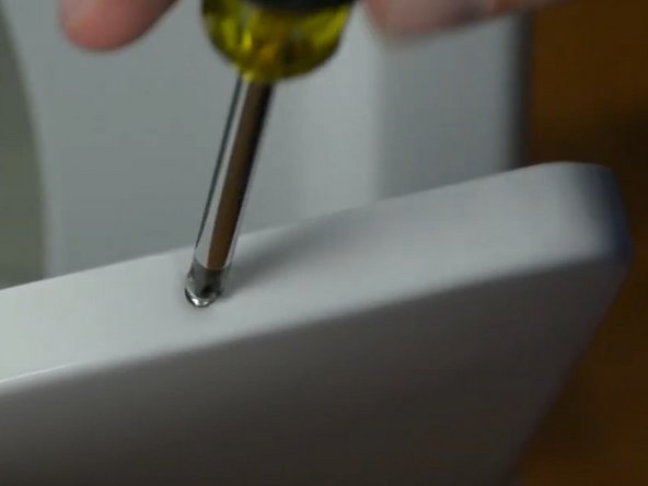

  5. Fast Fix Whirlpool Cabrio WGD5500XW1 Door Latch Replacement: 手順 5、 3の画像 1 Fast Fix Whirlpool Cabrio WGD5500XW1 Door Latch Replacement: 手順 5、 3の画像 2 Fast Fix Whirlpool Cabrio WGD5500XW1 Door Latch Replacement: 手順 5、 3の画像 3
    • Next, we'll replace the catch.
    • Remove the screws that are holding the inside of the door to the outside panel.
    • Once both screws are removed, you now have access to the back of the door catch.

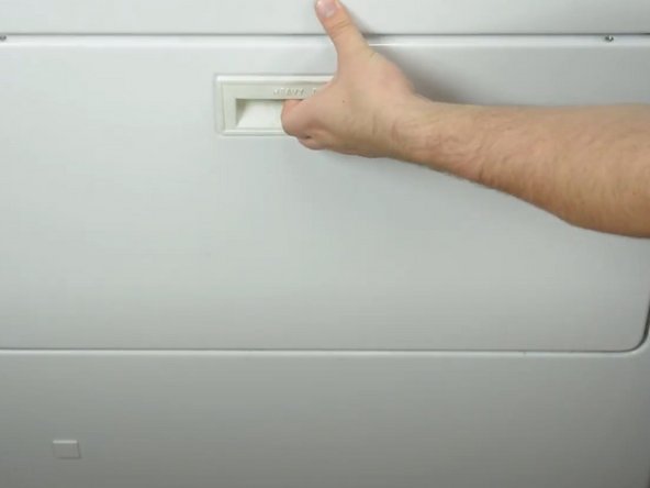

  8. Fast Fix Whirlpool Cabrio WGD5500XW1 Door Latch Replacement: 手順 8、 3の画像 1 Fast Fix Whirlpool Cabrio WGD5500XW1 Door Latch Replacement: 手順 8、 3の画像 2 Fast Fix Whirlpool Cabrio WGD5500XW1 Door Latch Replacement: 手順 8、 3の画像 3
    • Replace the screws that were removed and put the door back together.
    • After confirming the door shuts properly, reconnect the dryer to its power source and test out the dryer to ensure the door remains closed while in operation.
    • If the door remains closed during the test run, the repair is done.
