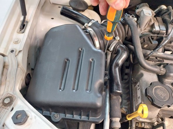

  1. Engine Air Filter Replacement, Chevrolet Aveo 2011, Air Filter Replacement: 手順 1、 3の画像 1 Engine Air Filter Replacement, Chevrolet Aveo 2011, Air Filter Replacement: 手順 1、 3の画像 2 Engine Air Filter Replacement, Chevrolet Aveo 2011, Air Filter Replacement: 手順 1、 3の画像 3
    • Replacing the engine intake air filter in Chevrolet Aveo (2011 European model) is a very simple maintenance task.
    • The replacement can be postponed further if you see that it is in fairly good condition. I change it every 15,000 km when I change the oil. I prefer not to rush it and I change everything on the same day.
    • We unscrew the four screws on the cover. it is not a matter of removing them, they remain in the plastic cover.

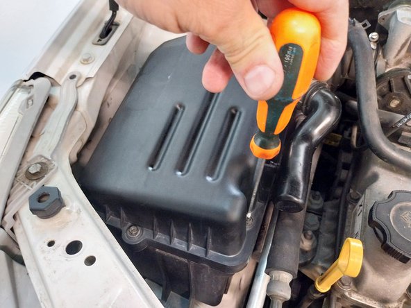

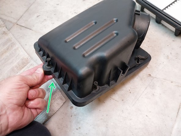

  2. Engine Air Filter Replacement, Chevrolet Aveo 2011: 手順 2、 3の画像 1 Engine Air Filter Replacement, Chevrolet Aveo 2011: 手順 2、 3の画像 2 Engine Air Filter Replacement, Chevrolet Aveo 2011: 手順 2、 3の画像 3
    • Loosen the screws, raise the cover and push it towards the front so that it doesn't strike the upper edge.
    • This leaves us with a perfect opening to be able to remove the filter.

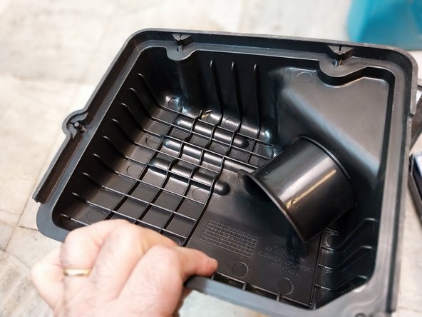

  6. Engine Air Filter Replacement, Chevrolet Aveo 2011: 手順 6、 3の画像 1 Engine Air Filter Replacement, Chevrolet Aveo 2011: 手順 6、 3の画像 2 Engine Air Filter Replacement, Chevrolet Aveo 2011: 手順 6、 3の画像 3
    • I never usually do this, but since I was doing the guide I took the opportunity to release the cover from the clamp and wash it with water and dish soap so that it is perfect.
