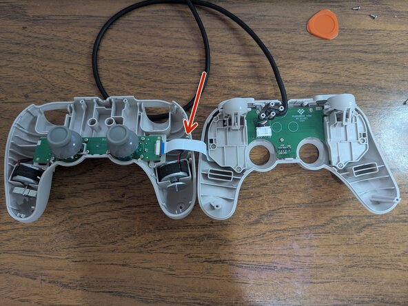

  3. Disassembling 8BitDo Pro 2 Wired Joystick Board, Open the controller: 手順 3、 3の画像 1 Disassembling 8BitDo Pro 2 Wired Joystick Board, Open the controller: 手順 3、 3の画像 2 Disassembling 8BitDo Pro 2 Wired Joystick Board, Open the controller: 手順 3、 3の画像 3
    • With an opening pick, detach the seven clips holding the faceplate. Start from the sides, towards the bottom.
    • Detach the remaining clips by carefully raising the faceplate away from the clips.
    • A flex cable joins both plates.
    • Move the faceplate to the side.

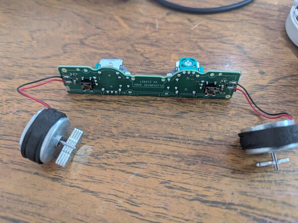

  6. Disassembling 8BitDo Pro 2 Wired Joystick Board, Remove the board: 手順 6、 2の画像 1 Disassembling 8BitDo Pro 2 Wired Joystick Board, Remove the board: 手順 6、 2の画像 2
    • Slowly lift the board from the controller. Make sure to lift both rumble motors as well.
