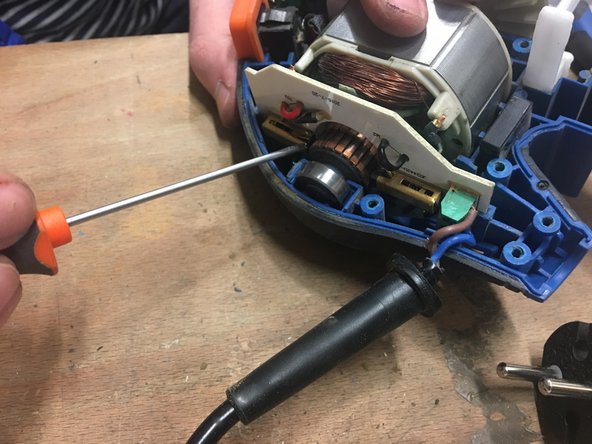

    • Trap the two carbons to be able to take out the rotor. With a screwdriver to lift them up, then with another screwdriver press the tab.
    • Lift the carbons and with the other tip of the screwdriver, come twist the small paw.
    • Then remove the carbon.
    • Remove the rotor by lifting the frame to be able to retrieve it more easily.

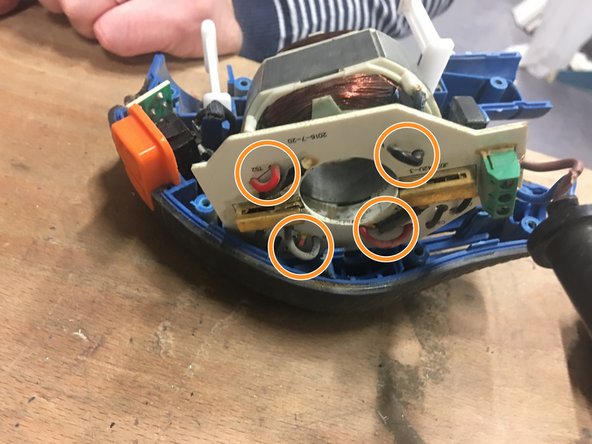

  4. Dexter Wired Multifunction Sander 220W - 220MFS2.5 Engine Replacement: 手順 6、 2の画像 1 Dexter Wired Multifunction Sander 220W - 220MFS2.5 Engine Replacement: 手順 6、 2の画像 2
    • Use a soldering iron to weld the component's rotor.
    • De-solder at the location of the wires.
    • Then remove the wires one by one to remove the component.
