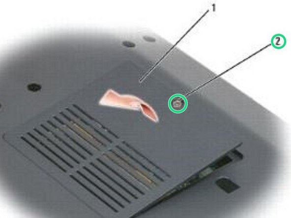

  10. Dell Inspiron 1521 Memory Modules Replacement, Loosen the Screw: 手順 10、 1の画像 1
    • Turn the computer over.
    • Loosen the captive screw on the memory module cover, then remove the cover and set it aside.
