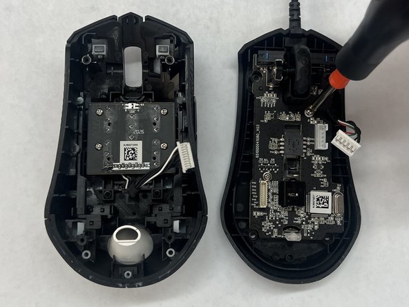

  2. Corsair M55 RGB Pro Gaming Mouse Motherboard: 手順 2、 3の画像 1 Corsair M55 RGB Pro Gaming Mouse Motherboard: 手順 2、 3の画像 2 Corsair M55 RGB Pro Gaming Mouse Motherboard: 手順 2、 3の画像 3
    • Use a Phillips #1 screwdriver to remove the four 10 mm screws from the bottom of the mouse.
    • There is a cable connecting the bottom and top of the mouse.
  3. Corsair M55 RGB Pro Gaming Mouse Motherboard: 手順 3、 2の画像 1 Corsair M55 RGB Pro Gaming Mouse Motherboard: 手順 3、 2の画像 2
    • Use a spudger to separate the top and bottom of the mouse.
    • Don't pull them apart as they are connected by a cable connector and could become damaged.
    • Pull the PCB cable away from the connector in the same direction as the individual wires are running.
    • Pull evenly on the full width of the cable so that no individual wires are overly strained.

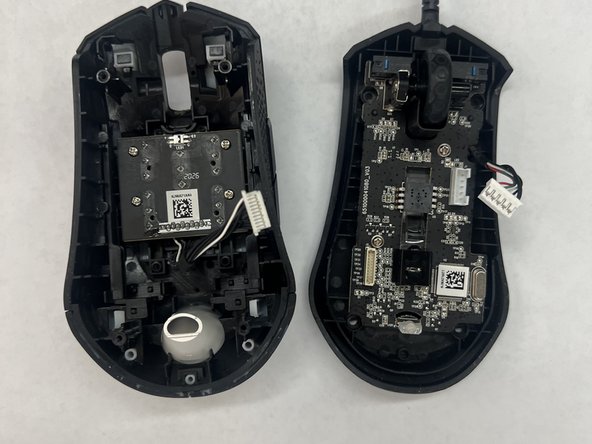

  4. Corsair M55 RGB Pro Gaming Mouse Motherboard: 手順 4、 2の画像 1 Corsair M55 RGB Pro Gaming Mouse Motherboard: 手順 4、 2の画像 2
    • Pull the USB pin cable away from the connector in the same direction as the individual wires are running.

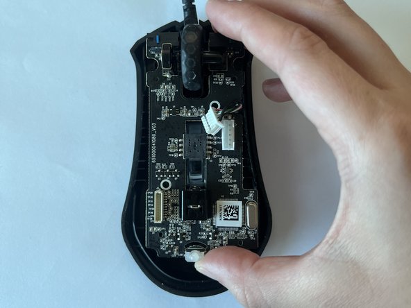

  5. Corsair M55 RGB Pro Gaming Mouse Motherboard: 手順 5、 3の画像 1 Corsair M55 RGB Pro Gaming Mouse Motherboard: 手順 5、 3の画像 2 Corsair M55 RGB Pro Gaming Mouse Motherboard: 手順 5、 3の画像 3
    • Use a Phillips #1 screwdriver to remove the two 5 mm screws that secure the motherboard.

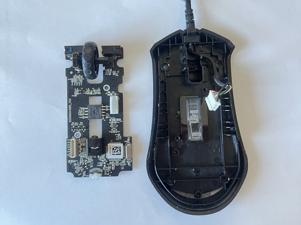

  6. Corsair M55 RGB Pro Gaming Mouse Motherboard: 手順 6、 3の画像 1 Corsair M55 RGB Pro Gaming Mouse Motherboard: 手順 6、 3の画像 2 Corsair M55 RGB Pro Gaming Mouse Motherboard: 手順 6、 3の画像 3
    • Carefully lift the motherboard out of the base of the mouse by the edges.
  7. Corsair M55 RGB Pro Gaming Mouse Motherboard: 手順 7、 3の画像 1 Corsair M55 RGB Pro Gaming Mouse Motherboard: 手順 7、 3の画像 2 Corsair M55 RGB Pro Gaming Mouse Motherboard: 手順 7、 3の画像 3
    • If necessary, remove the mouse wheel by sliding it to the right.
    • It should come out of the slot easily as it's not attached.
