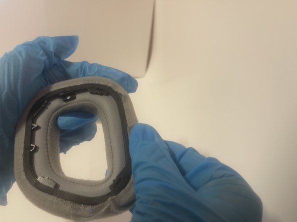

    • Remove the earpad from the headset by holding the earpad and twisting clockwise.
    • The earpad may be difficult to remove if doing so for the first time.

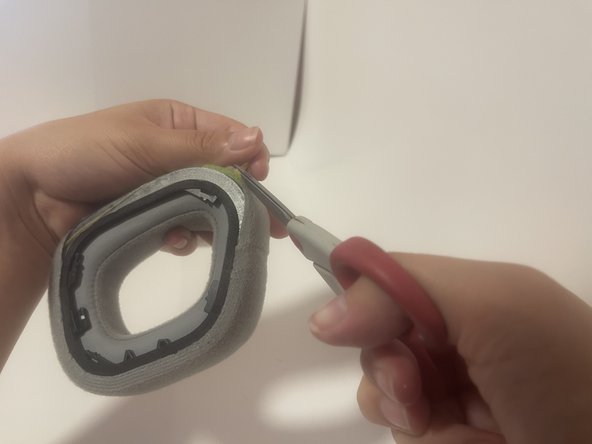

    • Take a pair of scissors and cut the old adhesive as close as possible to the fabric still adhered.
    • This will leave space on the cushion for new adhesive.

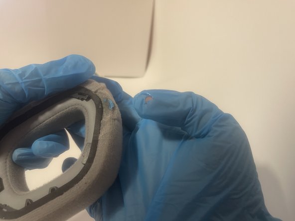

    • Apply adhesive to the free edge of the earpad where the cushion had detached.
    • Wear gloves while working with adhesive. You may super glue your fingers together or your skin to the project. Have a glue debonder on hand if gloves are not available.

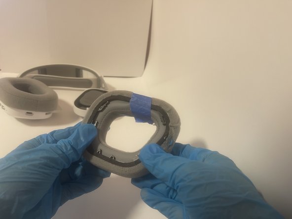

    • Wrap masking or painter's tape to hold the fabric and earpad together.
  7. Corsair HS80 Earpad Replacement: 手順 7、 3の画像 1 Corsair HS80 Earpad Replacement: 手順 7、 3の画像 2 Corsair HS80 Earpad Replacement: 手順 7、 3の画像 3
    • Insert a needle or sewing pin to hold the tape in place while the adhesive dries.

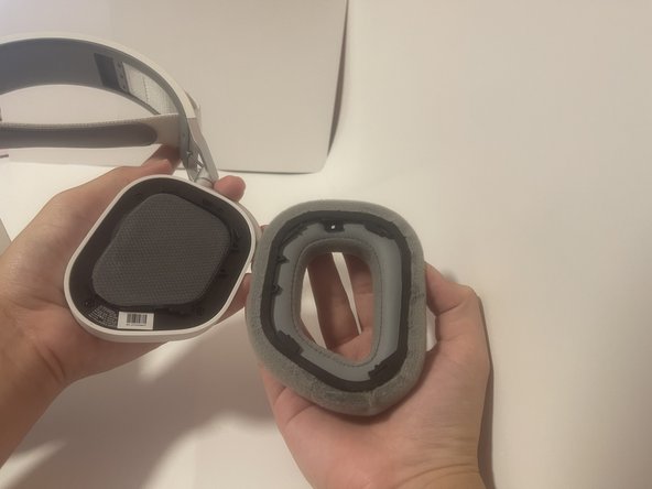

    • Reattach the earpad by lining the earpad in a clockwise direction and twist counter-clockwise to secure the earpad back into place.
