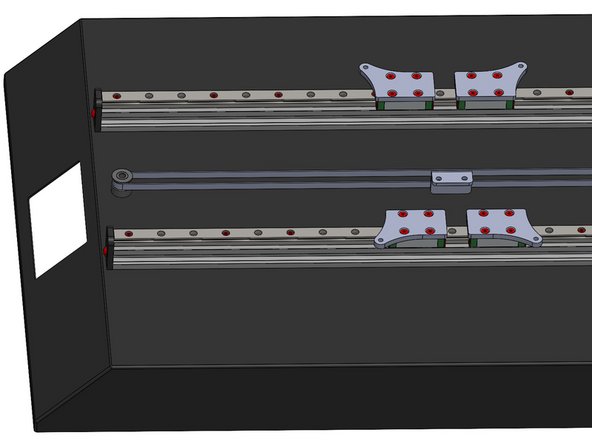

  5. CR-10S PRO Y Axis Linear Rail Kit Installation, Rail Adapter Plate install: 手順 5、 2の画像 1 CR-10S PRO Y Axis Linear Rail Kit Installation, Rail Adapter Plate install: 手順 5、 2の画像 2
    • Tighten the screws evenly in an X shape
    • 4x Adapter Plate
    • 16x M3x6 FHCS

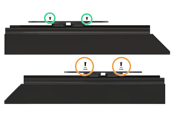

  7. CR-10S PRO Y Axis Linear Rail Kit Installation, Y Carriage Plate install: 手順 7、 3の画像 1 CR-10S PRO Y Axis Linear Rail Kit Installation, Y Carriage Plate install: 手順 7、 3の画像 2 CR-10S PRO Y Axis Linear Rail Kit Installation, Y Carriage Plate install: 手順 7、 3の画像 3
    • Belt mounting holes goes on the right side of the priter
    • Left side screws
    • Some early kits are drilled and taped for M5 Screws. The M4x8 FHCS is substituted for a M5x10 FHCS and the M4x10 BHCS substituted for M5x10 BHCS.
    • 2x M4x8 FHCS
    • Right screw stack order
    • M4x10 BHCS - M4 washer - M4 Large OD washer
    • Tightened the left side screws first

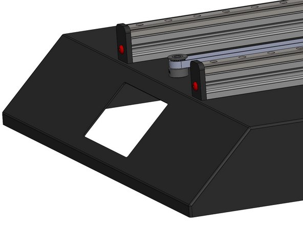

  10. CR-10S PRO Y Axis Linear Rail Kit Installation, Rail stopper install: 手順 10、 2の画像 1 CR-10S PRO Y Axis Linear Rail Kit Installation, Rail stopper install: 手順 10、 2の画像 2
    • M5*10 BHCS
    • Acrylic stopper
