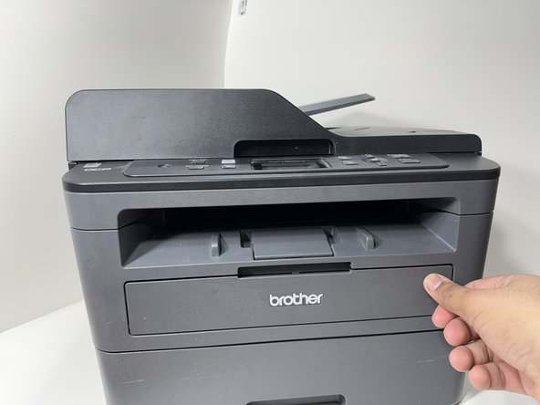

    • Pull on the tab to open the front plate of your printer.

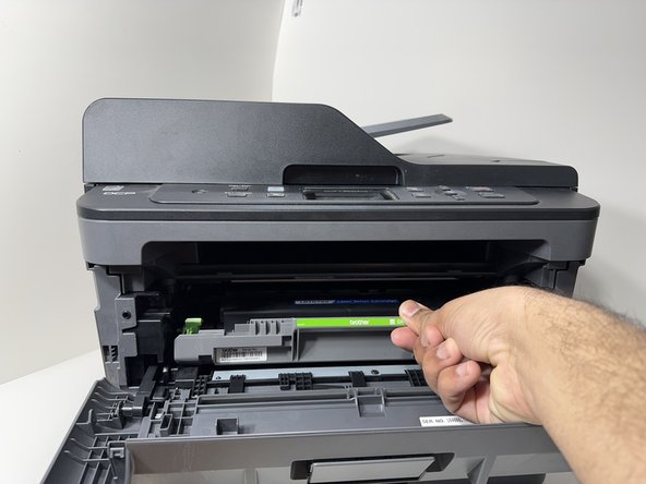

    • Pull on the green handle to remove the drum unit of your printer.

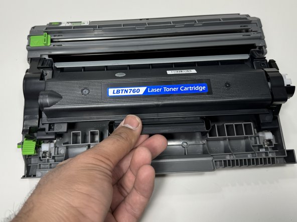

    • Place the drum unit on a clean flat surface.
    • Press down on the green button at the bottom left corner of the drum unit to unlock the toner cartridge.
    • Remove the toner cartridge from the drum unit.

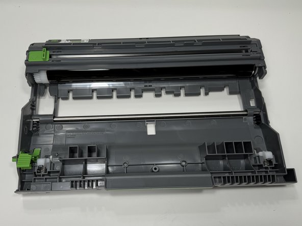

    • Insert the new toner cartridge into the drum unit by placing it on top of the drum unit and pressing it down, ensuring it is in the locked position.
    • Do not touch the ink roll of the cartridge. It can compromise the quality of the ink.

    • Close the front plate and ensure it is in the locked position.
