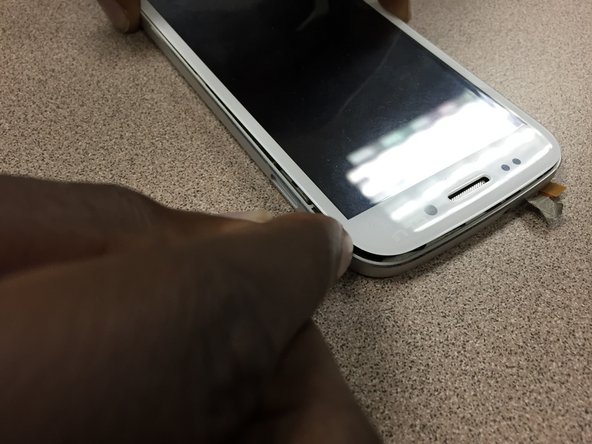

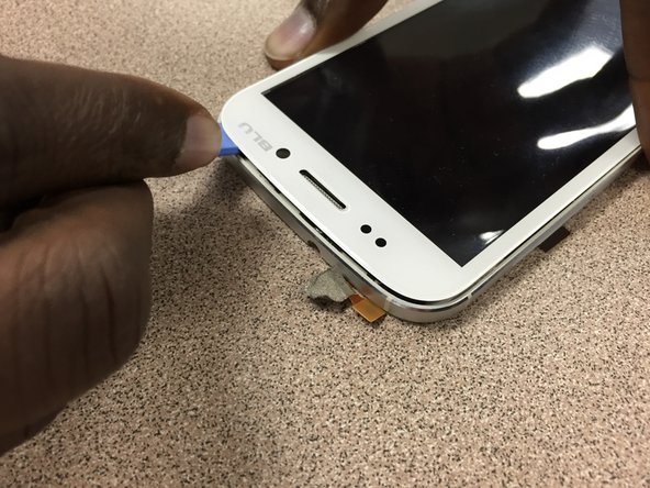

  13. Blu L120 Screen Assembly Replacement: 手順 13、 3の画像 1 Blu L120 Screen Assembly Replacement: 手順 13、 3の画像 2 Blu L120 Screen Assembly Replacement: 手順 13、 3の画像 3
    • Once the screen has been heated and the glue is tacky, put a plastic opening tool between the glass screen and the frame. Start lifting the glass away around the whole frame.

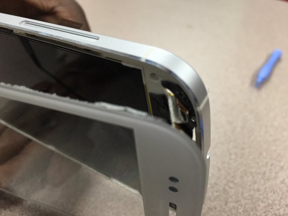

  14. Blu L120 Screen Assembly Replacement: 手順 14、 3の画像 1 Blu L120 Screen Assembly Replacement: 手順 14、 3の画像 2 Blu L120 Screen Assembly Replacement: 手順 14、 3の画像 3
    • When finished separating the glass from the frame with the pry tool, grab both the frame and glass with both hands and separate both pieces. CAUTION, there is a ribbon cable that needs to be removed from the back of the phone before full separation.
    • As you can see, the LCD still needs a bit more work to come apart.

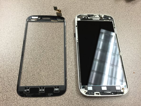

  15. Blu L120 Screen Assembly Replacement: 手順 15、 3の画像 1 Blu L120 Screen Assembly Replacement: 手順 15、 3の画像 2 Blu L120 Screen Assembly Replacement: 手順 15、 3の画像 3
    • Take a spudger and gently push the cable through the cutout on the frame to separate the glass.
  16. Blu L120 Screen Assembly Replacement: 手順 16、 2の画像 1 Blu L120 Screen Assembly Replacement: 手順 16、 2の画像 2
    • Congratulations! Your device is now ready for a new glass panel!
