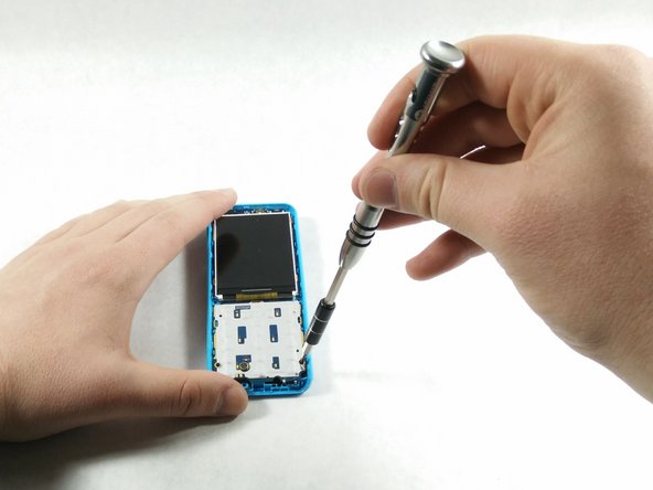

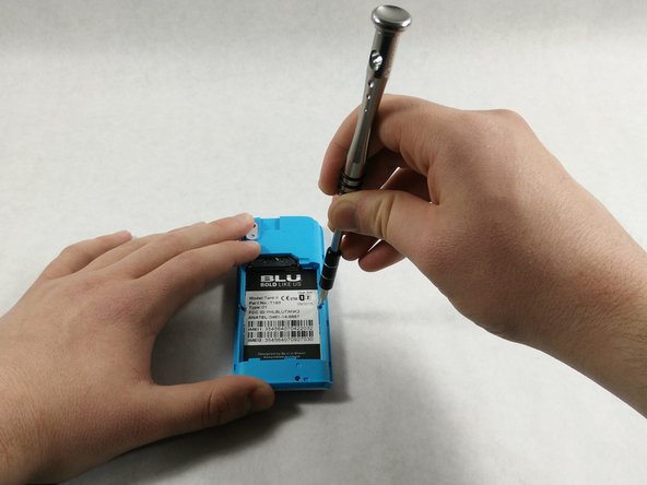

  3. BLU Tank II Outer Lens Replacement, Front Panel: 手順 3、 2の画像 1 BLU Tank II Outer Lens Replacement, Front Panel: 手順 3、 2の画像 2
    • Using the phillips head screwdriver, remove all 5 2.5mm screws.
  4. BLU Tank II Outer Lens Replacement: 手順 4、 1の画像 1
    • Wedge the blue plastic iFixit opening tool between the front plate and the outer lens plate.
    • Carefully separate the front plate from all sides of the phone.

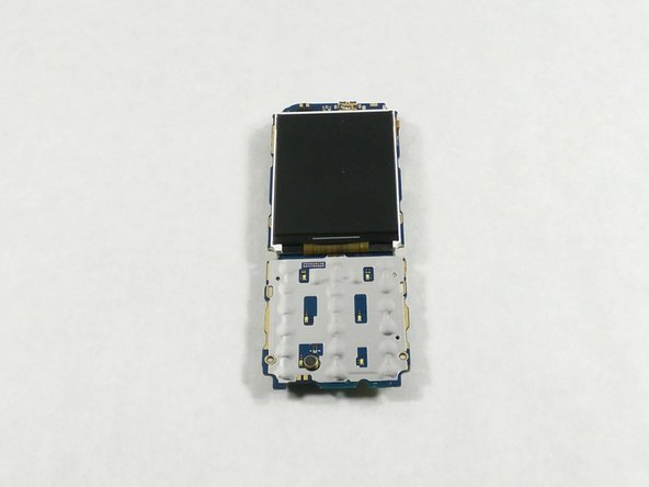

  5. BLU Tank II Outer Lens Replacement, Motherboard: 手順 5、 2の画像 1 BLU Tank II Outer Lens Replacement, Motherboard: 手順 5、 2の画像 2
    • Locate the two 2.5mm screws (red circles in image) and remove them with the Philips 00 screwdriver used previously.
  6. BLU Tank II Outer Lens Replacement: 手順 6、 3の画像 1 BLU Tank II Outer Lens Replacement: 手順 6、 3の画像 2 BLU Tank II Outer Lens Replacement: 手順 6、 3の画像 3
    • Once screws are removed, separate the motherboard and outer lens by carefully pushing the motherboard out with your hand as displayed in the image.

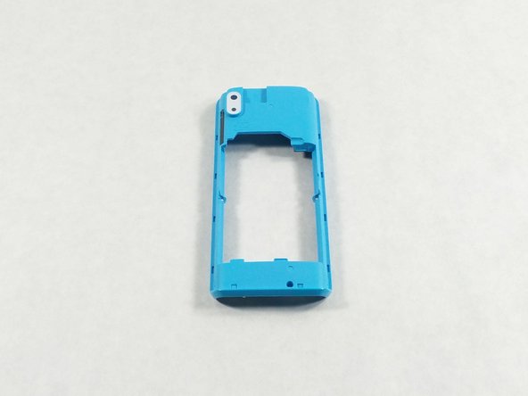

  7. BLU Tank II Outer Lens Replacement, Outer Lens: 手順 7、 2の画像 1 BLU Tank II Outer Lens Replacement, Outer Lens: 手順 7、 2の画像 2
    • Once separated from the motherboard, the outer lens can now be replaced.
