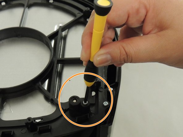

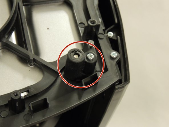

  5. BELLA TXG-DS14 The Spring of Silver Basket Stopper Replacement: 手順 5、 3の画像 1 BELLA TXG-DS14 The Spring of Silver Basket Stopper Replacement: 手順 5、 3の画像 2 BELLA TXG-DS14 The Spring of Silver Basket Stopper Replacement: 手順 5、 3の画像 3
    • You should find two connected black cylinders in the top left and right-hand corners of the device containing the two silver stoppers for the drawer.
    • Unscrew the 1.2mm Phillips #1 screws connected to the black cylinders by using the Phillips +1 driver, rotate it counterclockwise and remove it.
    • There should be one screw connected to each of the black cylinders.
