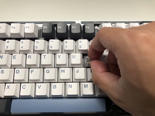

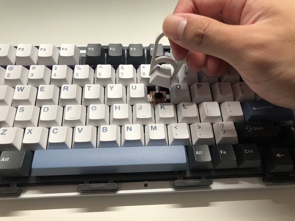

  4. Akko MOD 007 v2 Keyboard Switch Replacement: 手順 4、 2の画像 1 Akko MOD 007 v2 Keyboard Switch Replacement: 手順 4、 2の画像 2
    • Insert the keycap puller horizontally on the keycap and pull up.
    • Excessive force may break the tool or keycaps so don't yank the keycap up.
  5. Akko MOD 007 v2 Keyboard Switch Replacement: 手順 5、 2の画像 1 Akko MOD 007 v2 Keyboard Switch Replacement: 手順 5、 2の画像 2
    • Insert the switch puller vertically in the switch tabs and gently pull up.
