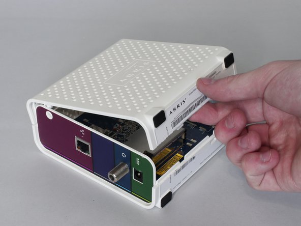

  4. ARRIS Surfboard SB6183 Modem Heatsink Replacement: 手順 4、 3の画像 1 ARRIS Surfboard SB6183 Modem Heatsink Replacement: 手順 4、 3の画像 2 ARRIS Surfboard SB6183 Modem Heatsink Replacement: 手順 4、 3の画像 3
    • Slide the left side panel of the modem toward the back, then up and out at a shallow angle.

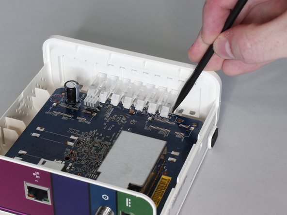

  5. ARRIS Surfboard SB6183 Modem Heatsink Replacement: 手順 5、 3の画像 1 ARRIS Surfboard SB6183 Modem Heatsink Replacement: 手順 5、 3の画像 2 ARRIS Surfboard SB6183 Modem Heatsink Replacement: 手順 5、 3の画像 3
    • There are small plastic tabs on either side of the clear LED diffuser. Use the flat end of a spudger to pry both of them outwards slightly.
