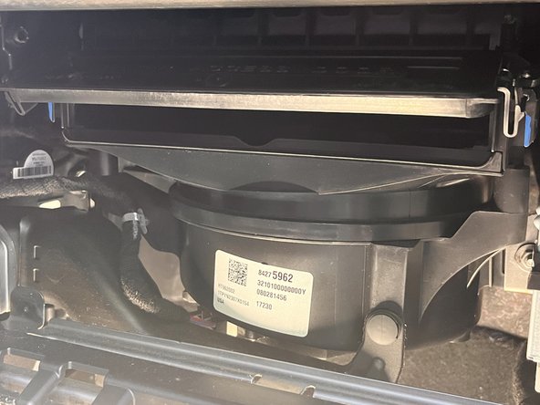

      • Plastic tabs will be right beneath the screws highlighted by markups.
      • Push the tabs in on both sides of the box simultaneously.
      • Lift the lid of the box to find the old cabin air filter.

      • Remove the filter, and check for debris in the filter box.
