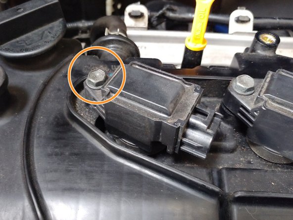

Unscrew the 10mm bolt holding the ignition coil in place.
Pull out the ignition coil.
