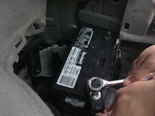

  3. 2009-2015 Toyota Prius 12V Battery Replacement: 手順 3、 2の画像 1 2009-2015 Toyota Prius 12V Battery Replacement: 手順 3、 2の画像 2
    • Always disconnect the negative (-) battery terminal first and reconnect it last.
    • Use a 10 mm socket/wrench to loosen the nut on the negative terminal (-) clamp.
    • The angle to reach the nut is a little awkward.
    • Carefully lift the clamp off the terminal and move it aside so it cannot spring back and touch the post.

    • Remove the 10 mm bolts securing the hold-down bracket.
    • Lift the hold-down bracket out and set it aside.
