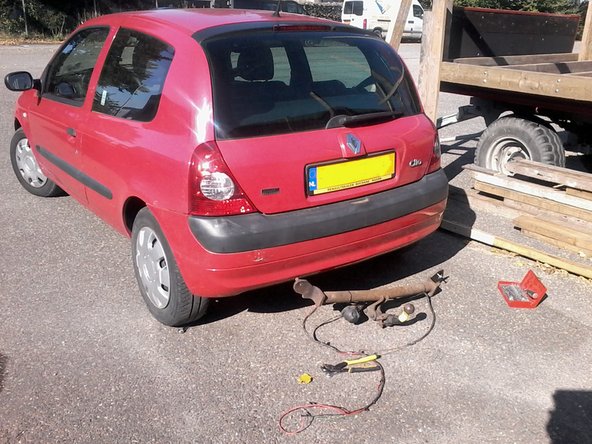

  1. 1998-2012 Renault Clio II Towing hook Replacement, Install a towing hook: 手順 1、 1の画像 1
    • Make sure you have all the components: 1 bar including hook and 3 flat thick metal bars with angle and holes. Also at least 8 bolts M10, 4 nuts, thick washers, and in addition have cable clips that connect automotive cables.
    • Make sure you have all the tools: torx 20 and 30, 1x M6 tube wrench, 2x M10 wrench, (a ratchet wrench is welcome treat, with it you also don't have to remove the left wheel to get to the last bolt)

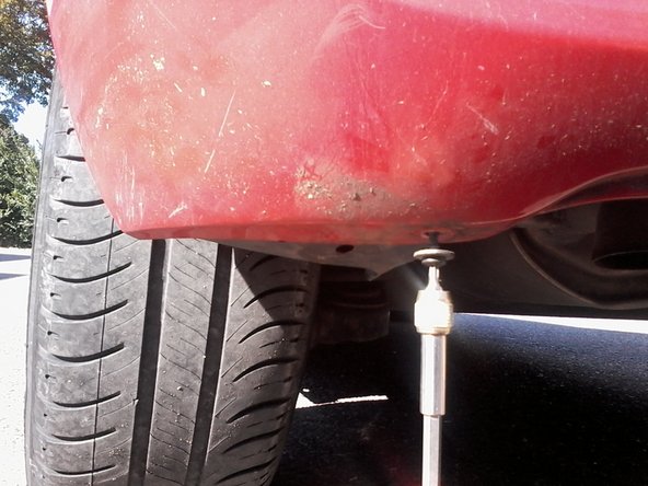

  2. 1998-2012 Renault Clio II Towing hook Replacement, Removing screws and bolts 1: 手順 2、 3の画像 1 1998-2012 Renault Clio II Towing hook Replacement, Removing screws and bolts 1: 手順 2、 3の画像 2 1998-2012 Renault Clio II Towing hook Replacement, Removing screws and bolts 1: 手順 2、 3の画像 3
    • Remove the T20 torx one left and one right.
    • On the inside of the wheelhouse there is one wing-nut (most likely weak black plastic ones if there still there ;)
    • Remove the 2 M6 bolts located under the bumper at the rear of the car (under the licence plate) they hold the white plastic insides of the bumper.
