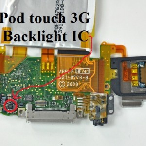

In my example replacing LCD did not resolve the issue
Reflowing (liquid flux + heat gun) IC responsible for backlight
did the trick for me
http://www.cyberdocllc.com/wp-content/up...
